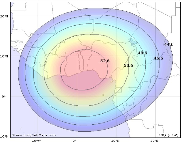

Silver Member Username: Jay_w_graysonPrague, Oklahoma USA Post Number: 659 Registered: Jul-08 | Anthony Obi Maybe I can help, what channels are you trying to get @ Intelsat 907 at 27.5°W? On C-band there are few true FTA channels. Ku has none. Foot Print of Intelsat 907 at 27.5°W ![]() |
Gold Member Username: TapemanNew York Citay in-HD, NY Post Number: 4423 Registered: Oct-06 | He says Darasat yo freaking moron FTAss Can't yo read Englic? TP75 is Free to Air yo idiot Anthony To get Darasat yo'll need: An HD receiver it's MPEG-4 with 8-PSK Linear Universal LNB LNB must be Ku Extended 11.555 GHZ they are sold in Africa or Europe 12.2 Ghz won't work Standard Definition receiver won't work This is not C-band It's not Circular either Specs are found here: http://www.lyngsat.*com/intel907.html Remove* As far as how to get it That depends on where yo live and how big is yor dish If yo live in Nigeria 60 to 75CM dish is required Universal Ku LNB 11.555 GHz MPEG-4 receiver with 8-PSK module I have no idea what is 4653x And Do yorself a favor Don't listen to the FTA_TESTER He's a pre-k beginner (14 years old aribian boi) If yo have any question on any satellite on earth Yo ask for King Nobody else |
