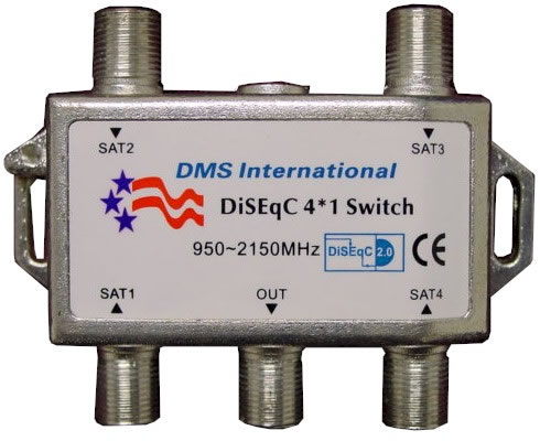

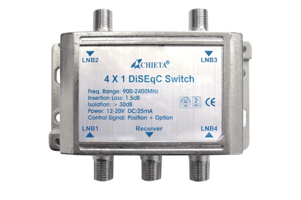

Guys i have these two switches but the problem is only port 1 and 3 and working at a time...when i connect 2 and 4 its totally dead so please tell me which switch u all have .............
I m having problem when i need to watch international channels i need to switch wires again and again......becuase 2 ports are dead
SO i m looking all 4 ports working swtich pls help me and post switch photo thanks

The switch on first picture only work 4 days for me, this a crap.
Buy a heavy duty outdoor switch.

in both switches 2 prts are dead..i dont know y
i think voltage burn 2 ports i guess.

prado both switches are good.
I have used both of them with no problem.
the Chieta is the better of the two.
When you install a DiSEqC Switch or change ports
you must turn off your receiver first.
If your receiver is on when you change from
one port to other you may be touching ground
and shorting out that port.
Expose to the weather will also damage the switch.

prado are they the same ports on both switches?
If they are then you will need to replace the 2 wires from the LNB to the switch.

Username: Topy
Post Number: 105
Registered: Jan-07
Prado,,, I had hard time with all these switches, then I get rid of all these, Buy a EMP Century switch, before buy I will give u a tip with first swtich, change your diseq setting from 2.0 to 1.1, u will see port can be recogise, the big question is that which receiver u r using? I had same problem with Kbox when I change switch setting from 2.0 to 1.1 bam it worked , try & post the result if failed post the sat info, receiver name & setting. we all will try to fix. thx
