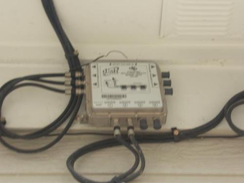

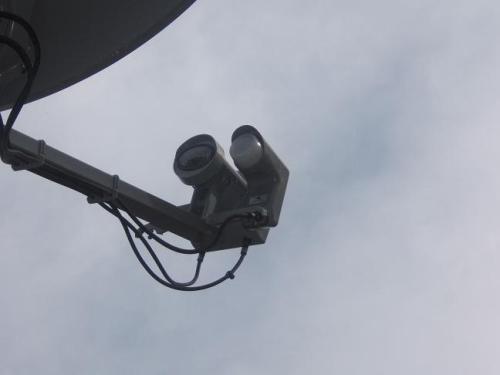

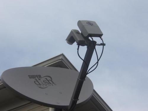

Hi Guys,
I have attached the images for the dish and Switch.
I have played around with the ports with no luck at all. I only get 110.
When I didn the System Status process on DN receiver it detected problem with 2 satellites.
I have a Super Dish, 2 LNBs, and 1 Switch (DP34). Please see if the images can provide more details.
As you can see I have 3 cables coming from Dish and 2 cables going towards two receivers. Please note that I only use 1 receiver but if you want me to try I can hook 2 receivers (My VS Ultra and DN HD Recevier) and see if the problem is with the cable going to the main receiver that I use every day.
Username: Nydas
Post Number: 15425
3x4 Multiswitch
Dish Network DishPRO DP34 switch
3 Orbital Locations, 4 Tuner Outputs DP34 Switch Features
* The first switch in the new DISH Pro Technology series of LNBFs and switches.
* Three inputs for use with up to three orbital locations.
* Four outputs for connections up to four tuner inputs.
* Three "trunk" connections, to "trunk" to another DP34 Switch.
* Does not require power insertion.
* Can be used indoors or outdoors.
* DishPro switches may be cascaded 3 switches deep and are DiSEqC Compatible.
Special Considerations
* Can only be used with DISH Pro LNBFs (DISH Pro Twin LNBF for two orbital locations (110A° and 119A°), DISH Pro Twin LNBF with a DISH Pro Single LNBF for three orbital locations or up to three DISH Pro Single LNBFs).
* When used with a DISH Pro Twin, the LNBF operates in its default state: one port provides 110A° and one port provides 119A°. Either port of the DISH Pro Twin can be connected to any two LNBF ports of the DP34 Switch.
* Tuner Outputs: DISH 301 and DISH 501 have one tuner, and would use one DP34 tuner output; DISH 721 has two tuners, and would use two DP34 tuner outputs.
* Up to three DP34 Switches can be "trunked" together, for connections up to twelve tuner inputs (12 single-tuner receivers (DISH 301 or DISH 501), or a combination of single-tuner receivers and two-tuner receivers (DishPVR 721).
* There must be at least one DISH Pro receiver (or a legacy receiver with a DISH Pro Adapter) connected to the switch at all times to provide power. The receiver can be connected to any receiver port on the DP34 Switch.
* DISH Pro Installations can support up to 200' RG-6 cable lengths, from the LNBFs to the furthest receiver. DP34 Switches can be placed anywhere in the installation, but placement closer to the receivers is recommended.
i· Two styles of DP34 Switches will be sold. Both switches provide identical features and functionality, but have different exterior cosmetics.
