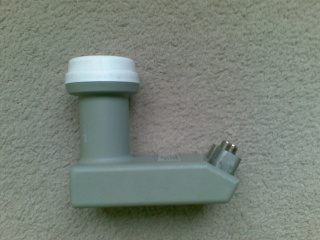

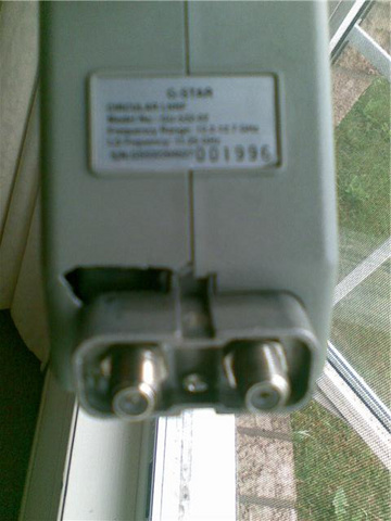

Username: Dj_prince
Post Number: 27
Registered: Feb-08
Hi nalin iam uploading some pictures of the lnb that i have right now if has the following spec it says on it
G - Star
CIRCULAR LNBF
Model no. GU-532-02
Frequency Range: 12.2.12.7 Ghz
LO Frequency: 11.25 Ghz
please let me know if this is compatible if not then i'll get the one that ur refering to thanks
Username: Riconissan
Post Number: 1426
Registered: Feb-09
looks like you are throwing out the window.
That will not work for 118.
http://transatelectronics.com/store/lnbs-1187-lnb_CA151_66_100
Username: Nydas
Post Number: 15368
No DJ. That will not work. What you need is
# Polarization: Circular
# Input Frequency: 11.70 - 12.75 GHz
# LO Frequency: 10.750 GHz or less
Username: Dj_prince
Post Number: 30
Registered: Feb-08
hi people yes i got 33 inch dish and the right LNB and installed it , and it worked !!!!!! everything is working fine, but some times KHUB light goes yellow and then come back green so is it normal? or its just me ?
