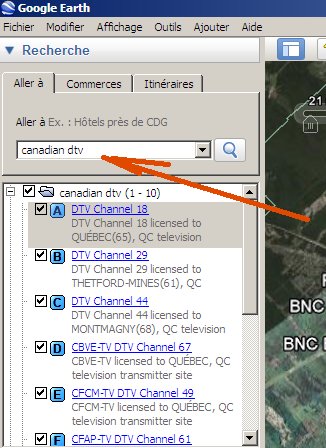

If you go on Google Earth and type Canadian DTV (see picture below) you will get the list of sites and can look at their locations
Beware of the Ch 67 below. It is the English CBC (CKMI from Myrand Blvd). The French CBVE is atop Mont Bélair
