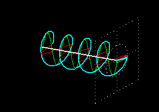

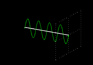

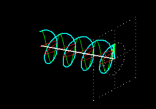

Gold Member Username: PlymouthCanada Post Number: 8999 Registered: Jan-08 | joeturn Give me a good link because I don't see nothing of it on web. joeturn It seems you lose something, on a motorized dish you put only one LNB and this LNB need to be on perfect focus of dish for get all satellite available. Linear mean: Vertical = low voltage +-11.5 volts Horizontal = high voltage +- 15.5 volts Circular mean: Right = low voltage +-11.5 volts Left = high voltage +- 15.5 volts As you can see circular use both: Vert. and horiz. the delay between 2 wave give right or left hand. Vertical: Horizintal Right Left ![]() |
