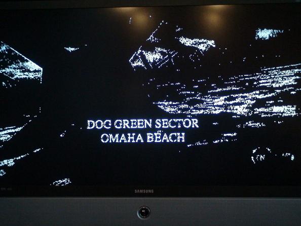

I have a Samsung HLN617WX/XAA DLP TV. For about the past month, after startup the TV has either 1) gone blank with no picture or 2) freeze with a scattered set of white pixels. The frozen images of white pixels changes to whatever is displayed last (actually, its not completely frozen, if I stare long enough, I see pixels change state, either to black or white).
Here's an example of a "frozen" state:
I've tested this with DVI input and an analog input antenna-a. When it does go blank/frozen, I still get sound. I also get no blinking light indication of an issue. The power button on the remote does work to allow me to turn it off. I can change analog channels, change volume but no display works, i.e. menu, tv/video, pip, etc.

Hey Brandon, I have the same TV and now I am seeing the same problem recently. Exactly the same. Did you ever find out how to fix it? Is it the color wheel or the DMD board that needs replacing?

It definitely looks like a DMD board issue where the color wheel and the DMD chips aren't communicating causing the gray-scale image instead of a color image. As far as the pixels turning on and off, that's the micro-mirror tilting at the wrong frequency. The faster they tilt, the lighter the pixel. The slower they tilt back and fourth, the darker the pixel.

mine does same thing, looks just like the pic posted above?
