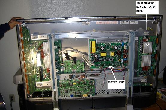

Username: Hect7369
Post Number: 9
Got a Vizio P50 HDM,set is in shut down,led blinks from orange to green 9-10 times.Just a flash is seen on pic,when set tries to turn on.
A strong chirping is heard on board as ovadoggvo shows in post(boards) above.Is possible this board is defective.?? No print.
Anyone has the part number for this?
Any help will be appreciated!
Thanks!
I post a pic..may be can help to all who has one of these sets.Upload
