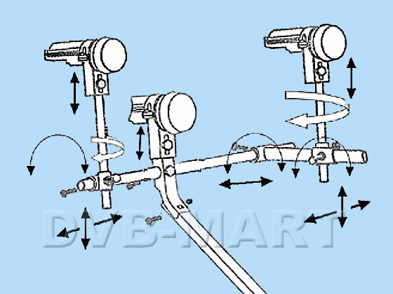

Can I get Galaxy 18 (123W), 16 (99W), 3C (95W), 17 (91W) on one dish in a fixed position with an adjustable LNB mounting bar? Or is the 123w Bird too far away to get from the others?

Yo can get 4 degrees apart with a 90CM dish very easy
[link removed]
Jake
91 with any sat on a 30" dish is no problem
But using a 90 CM dish is the way to go
75CM=30"
90CM=36"
1M=40"
Look into this multi LNB Bracket
Available on e-bay by MX-Mart
Also SatelliteAV in California sell special LNBs and brackets
[link removed]
Let me tell yo
This is a very challenging installation
But very doable on a 90CM to an expert installer
If yo were to try it
start with 2 LNBs then add one LNB at a time

That's the bracket I bought, except it holds 6 separate LNBs.

Jake you can't get all satellites you listed,"""Galaxy 18 (123W), 16 (99W), 3C (95W), 17 (91W)"""
OK for 99, 95 and 91 but too far for get all Tp on 123W(possible if you live in Californy).
The problem is when you move away from the dish center,you lose the focus point and lose much signal.

The bracket yo bought and what I posted are 2 different things
I'm very familiar with the one that holds 6 LNBs
It's not the same
I need to know what are yo trying to get with 99W and what state do yo live in?
