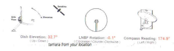

Saturday, April 04, 2009 - 12:22 GMT tamara...for Galaxy 19 at 97.0°W try these settings Dish size 33" or larger LNB Linear

Saturday, April 04, 2009 - 12:31 GMT Tamara Globecast is now on Galaxy 25 97W, use a satellite name with 97W. You must have a 30" to 36" dish and a Linear LNB Here is the setting info: LNB Type: Standard LNB Freq: 10750 Tp Freq: 12059(Strong TP) 22000 H 3/4 Don' t forget to adjust the skew, very important with a linear LNB. 2 sites for aim your dish: http://www.dishpointer.com/ http://satcalculator.freehostia.com/

Saturday, April 04, 2009 - 13:27 GMT Can i get on Intelsat5 97.0W Ukrainian and Polish channels? IS the dish pointed in a complete different directions? almost opposite of Dish net?
