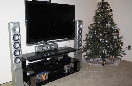

My latest spin of the CSR roulette wheel yielded a friendly lady who made me a much better offer (Thank you to Debbie, wherever you are!). Granted, I didn't get the GREAT offer, but I did get more than I expected.
I was quoted anywhere from $466 for a 42V to $1093 for a 52W. This was a substantial jump on their part as my quote about 24 hrs before was $1723 for the 52W, which had me thinking of getting the tech back out to my place. I reluctantly agreed to pay 5% MA state sales tax and $215 "white glove" shipping as well. When I called to order I asked them to waive it and Pat informed me that they cannot do that. I figured, "What the hay?", I'm getting a phenomenal TV that's a foot larger than my old dinosaur. I was very tempted to go with the 46Z, which would have been $827 + tax & shipping. I went to Circuit City today and watched the beginning of the new Batman movie on blu ray and it simply 'BLU' ME AWAY. I mean wow, and pun intended.
I realize that some here will think this was a bad decision on my part, but I disagree. My warranty with Sony had expired in July of 2008 and my extended warranty with Best Buy had expired last January. Technically, all they had to do was give me the warped door service, but instead this is a very nice discount and avenue for me to get out of this nightmarish technology and into the new age of TV for less than 1/2 of what I payed out for my TV setup five years ago.
I also realize that some will say Sony just bought me out of a class action law suit, and that's perfectly fine with me. I'm not greedy or thinking I deserve a new TV without paying ANYTHING, so I consider this a very fair compromise based on my situation and realizing that everyone's is unique.
I would also ask those who are looking to get their set fixed ... um, why? Why stay with a BAD design and old technology? If you haven't seen a blu ray on these new sets, go check it out and you may change your tune. I ordered a new bulb and will sell my 42" Grand Wega on the cheap or just give it to someone (I'm thinking of my parents).
Finally, if all this makes me unconcerned about the "common good" in some eyes, then so be it. The way I look at it is my headache is over and Sony has graciously restored my peace of mind (even if it was not from the goodness of their hearts).
One last note ... I read a lot of posts about having difficulty getting the serial sticker off. Mine was a snap. It was a big laminated sticker I simply pealed off very slowly and it came off almost completely in one piece. Just thought I'd give that little tidbit of advice for those who are taking advantage of the replacement offer.
Merry Christmas everyone! I hope you all find peace in your endeavors with this saga as well as in life in general. And once again a huge THANK YOU to all who came before me and made this process relatively painless.
Take care & God bless,
- Doug

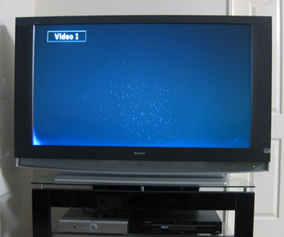

Just got a blue-ish blob in the center of my KDF-42WE655.
Is this the beginning of the "optical block" issue?
What should my next step be? Contact customer service or straight to a repair shop?

Welcome Tim,
If you haven't already done so, you could start by reading up on some of the common "OB" problems.
This is an excellent resource for that:
http://splinke.googlepages.com/sonyrearprojectionlcdtv-opticalblock
Also, check out Sony's support site for your particular model for warranty info (most have it for at least the warped door issue):
http://esupport.sony.com/US/perl/model-news.pl?mdl=KDF42WE655&LOC=3
If you have an extended warranty, you should be golden. If not (and I'm assuming you don't if you are here) ... well, it may take some doing based on your particular case.
Assuming your lamp door is warped (as most seem to be at this point), call Sony (888-649-7669) and have them document the details of your situation and give you an "E#" (case number). The CSR should then refer you to affiliated servicemen in your area for the lamp door issue.
My advice is to be polite, patient and informed, but that is just me.
Good luck!
- Doug

KDF 42WE655 with blue blobs taking over the left-half of the screen. Just another victim.

Im another one who got stiffed with a kdf50we655, getting the o/b replaced tomorrow, I paid 2799, for this set 2 years ago, I didnt want to pay 1200 for the 52" replacement, they offered,
they got me once, and only once, my friend picked up a samsung 60", and it is far superior to the sony in every way
when I purchased my set, I was paying extra for the name, I thought sony was the best, boy was I wrong,
I want some proper compensation, and a realtime guarantee that this problem (blue blobs) isnt coming back in a year or two, I will NEVER buy another sony tv after this, unless they really make good on this problem, not by trying to rope me into another one of there iffy products....Im PISSED!!!!

well they fixed the set today, I thought I was at least a little happy the blue blobs had gone away, however after watching for about 2 hours, this very annoying high pitch whirring sound was coming from the back of the set, keep in mind it never did that before, on closer inspection it appears the fan from the rebuilt o/b is noisy, Im assuming this is part of the o/b or they would have put my old fan back in, arrrrgggg.... just cant catch a break,now I got to start complaining again, its loud enough that its aggravating to listen to
guess this o/b probably is a high miled rebuild from some bar that had there set on 22 hours a day........
