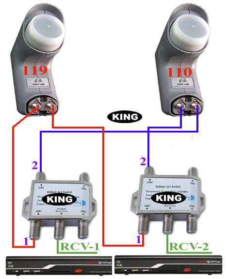

DP44 yo don't need a splitter if setup correctly
Yo can run a second coax wire for second receiver
DP44 can supply 2 receivers
Yo can also use 2 DISEqC switches if yo still got problems
If yo can't reach the DP44 for a second coax
Then yo can split signal but yo have to share polarities
- For example yo may leave unused receiver on any Vertical polarity and the second receiver can tune to any channel
- Yo don't have to turn off one receiver instead yo tune it to any Vertical polarity channel
- Its what I call polarity sharing
This is jow to split a satellite signal
But yo can split it inside the house if easier for yo
Click here:
https://www.ecoustics.com/cgi-bin/bbs/show.pl?tpc=2&post=1496579#POST1496579
