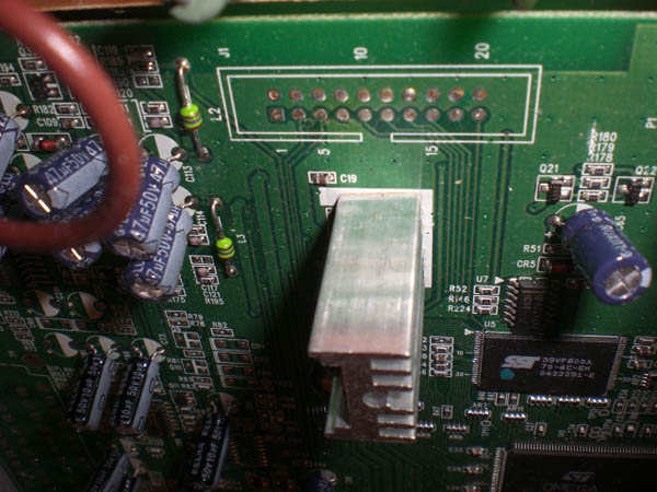

So here is what I did:
1. Open up the Pansat 2500A Box.
2. Took a couple of pic's of the circuit board.
3. Realized that I need to manually solder the JTAG Header.
Now the issue becomes: The sodering on the board is very close together - I'm going to have to figure out a way to do this very carefully. Also, I'm going to try to figure out who sells the 20 pin jtag headers.
Here are a couple of pics so far of my DIY project:
Username: Nydas
Post Number: 14238
This is bit more complicated for you than I thought it would be. If you are happy with the soldering iron, you could make your own cable and solder it directly to the board. Do not forget to use the resistors.
Here is a URL to some files and instructions. Tiger Woods and Plymouth in this site might be able to help more
Jtag files and instructions
