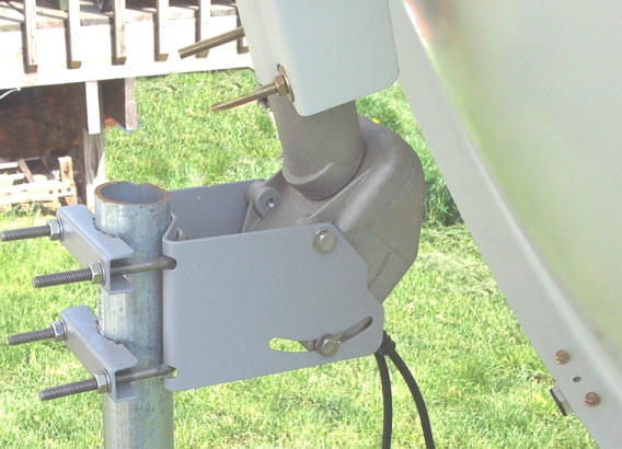

Gold Member Username: PlymouthCanada Post Number: 6846 Registered: Jan-08 | Rob i think you must put the motor arm in up position for your Winegard dish. Put it as for this picture with same settings. I,m able to select your motor in dishpointer and it give same settings as for the other tool. |
Bronze Member Username: Viewsat_ultraPost Number: 63 Registered: Nov-07 | It's kind of odd that it would go upside down but I'll try it.Being up-side-down when I set the degree of the motor shaft should it be on the "Latitude"side of the bracket or on the "Elevation"side? The picture shows the Elevation side of the bracket. Thanks. |
Gold Member Username: PlymouthCanada Post Number: 6847 Registered: Jan-08 | Rob the Latitude is always on motor bracket. On my small 18" Winegard (BEV) i had made 2 plate whit 4 hole to move away the dish and motor because i had not swivel the motor. ![]() |
Gold Member Username: PlymouthCanada Post Number: 6848 Registered: Jan-08 | Rob the Latitude is always on motor bracket. I do a correction. |
Gold Member Username: PlymouthCanada Post Number: 6849 Registered: Jan-08 | Ron please are you able to take a picture of your motor and dish, i want see the Motor bracket and dish bracket. A picture that i can see the scale on the side of your system. ![]() |
Gold Member Username: PlymouthCanada Post Number: 6850 Registered: Jan-08 | Rob please are you able to take a picture of your motor and dish, i want see the Motor bracket and dish bracket. A picture that i can see the scale on the side of your system. ![]() |
