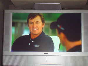

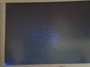

Hey, I was looking on Craigslist for a TV and I came across a Sony KDF42WE655 with the dreaded "blue blob" problem. It is listed for $350.
The ad showed the pictures of the blue stars and a wider picture of the full screen. The blue blob doesnt seem to have an effect on the overall picture.
I became interested and researched and came to this forum. I also came across this:

Here are the pictures that were on the craigslisting.
Post Number: 118
From everything I know of the blob problem and the part(s) it affects, and having seen the damaged LCD myself, it seems like simply replacing the damaged LCD and CAREFULLY cleaning the OB per the instructions on Steve Linke's site, would be the best and cheapest course of action. Provided of course that it's done by someone mechanically inclined and technically competetent. Any person capable of replacing their own OB though should certainly be able to replace the affected LCD in their OB.
So it comes down to whether or not the damaged LCDs can be obtained (stands to reason they should), finding out what their part #s are depending on which OB your set uses (you can find a list of OB models on Steve's site), and finding out who sells them (presumably just Sony). Not sure how much luck anybody is going to have trying to get the part #s from Sony though, might have better luck getting them from Tri-State since they clearly are purchasing them to refurbish the OBs.
It would be most helpful if somebody could find out the part #s of all the LCDs for all the OBs used in the Sony RP TVs (I believe there are only about a dozen different OBs), and provide that information to Steve so he can add it to his site. Alternatively, if someone could at least find out the part # of the LCD which is closest to the heat source on each of the OBs that should be sufficient to help most people.
I'm keenly interested to see feedback from anybody that successfully repairs their own OB which suffers from the blob problem, and also to find out how the repairs fare over time. Will it last as long as a new OB, or even as long as a refurbished OB? Will the other LCDs a little further from the heat source start to develop the haze on the LCD before the replaced LCD goes bad again? Nobody really knows if the other LCDs will ever eventually go bad as well, because everybody either replaces their bad OB after the LCD closest to the light source fails, or they junk their TV.
Considering how much these TVs cost originally and how many people purchased them, we should all do everything we can to help find a way to inexpensively, if not effortlessly, extend their lifespan for as long as possible. For the green minded folks out there, we should do it simply to avoid having the parts from 10s of thousands of these things wind up in landfills.

I know you guys keep saying that the KF-42WE610 is from Sonys 2003 series,but the sticker on the back of my tv is dated APRIL 2004.My extended warranty is good thru JUNE 2009.I have started getting the blue blob at the bottom middle of the screen which shows up on white and some lighter colors only. If something is in letterbox format, I cannot see it at all,which is great as I only watch my movies in widescreen anyway.It comes and goes,sometimes barely visible,other times it gets up a bit higher on the screen,however, it never seems to get any higher than about 2 inches.If anyone lives in the greater Seattle area, they are more than welcome to purchase this tv from me for what I paid for it on CL, and they could possibly get a new tv.I just do not have the time or financial means by which to jump thru the hoops or accept any "discounted" offers on a new tv from Sony.If anyone is interested,shoot me an email to
shereecontreras@msn.com
I am posting a couple of pics with the blue and how the tv looks with widescreen on,so you can see it does not affect movie viewing in that format.
Thanks!
Post Number: 11
Well, I tried to post pics...but they did not show up...I will try this again.
<img>
<img>
Post Number: 12
Well, obviously I cannot figure out how to post a pic,sorry. But if anyone is interested in the tv,I can send a pic thru email.
Thanks!

Hey, I have been through all the threads here concerning Sony, as an owner of a KDF-50WE655 that has been great since I purchased it in December 2004, after year 1 there was a yellow blotch issue that was covered under warranty, they put in a new light block... anyway this month the bulb blew out,I found the exact phillips bulb and replaced it, when we fired it up we immediately had the blue flare on the left side of the screen, it is an authentic phillips bulb too. So I did some research found this place and read everthing, went to Sony's website were they have pictures of exactly my blue problem. I called they immediately offered the KDL52W4100 for $843 and the other options... I took it, I mailed in the S/N sticker today after I called them and set everything up. The current TV still works great just has a little blue on the left, which is getting slowly worse. We will move the old TV to the basement and hook up a DVD player for kids movies and put the new one in the family room with the theater system etc. I would never have known about any of this without you all, I wanted to thank you. I will update you as to the status of the new TV when it arrives how long it took, the entire process.
Thank you,
Bmoney
Username: Edenney
Post Number: 142
Adam/Bmoney/whatever,
Just a couple things... You were very lucky to have somehow slipped through the cracks and received that offer to upgrade to the KDL52W4100 for $843. All the other WE series owners have received terrible offers because those are actually 2003 series TVs. The offers are about the same as if you just bought the same LCD from a good online etailer instead of paying Sony's jacked up direct prices. Can't see any way that Sony can back out of their commitment now so you should be ok, but everybody else with your series TV is getting screwed.
Another thing, that blue blob is going to rapidly get worse. By rapidly I mean that it will go from the first signs of noticing it, to pretty much covering the entire screen within a period of about 60 days with very heavy use, about 120 days with average use, about 180 days with very moderate use. Sounds like the blob is already very noticeable once a new bulb was installed, so adjust those numbers accordingly. In short, that TV is going to become a 100+lb. paperweight in very short order unless your kids don't mind everything looking like Smurfs, so don't go to much trouble relocating it with the expectation that it's going to be usable for very long.
You may want to consider replacing the OB though if you just want to use it as a TV for the kids to use occasionally. You can exchange your OB for a refurbished one for between $325-$375 and the instructions to do the job yourself can be found on Steve Linke's website (just scan this page to find it). It's not exactly a no brainer, but it's definitely doable and only takes experienced techs about 30 minutes. It's not however cost effective to have it repaired professionally.
