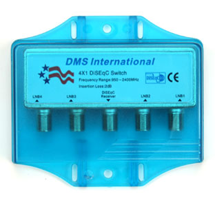

If ya have a switch still connected, suggest ya replace it too and weatherproof with a cheap plastic tupperware container or put it inside out of the weather, if posible.....and always keep a spare...disque 4x1 switches are only $5 at many places..

Don't listen this old idiot and buy a heavyduty outdoor switch like this one, North Canada tested:
I buy this one after i change 4 switch, 3 in only 2 weeks.
This the last you will changed
No need Tupperware LOL to good

Don't use that site from plymouth...they have had tons of complaints and been identified as scammers..Satscams has had tons of reports from people who used gosatellite site...
BTW...tupperware sealed plastic works well anyplace...no need to buy expensive or from a scamming site ...
