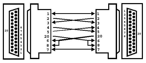

null modem cableUpload

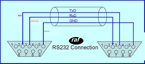

thanks i think i have wrong cable.both ends look alike.one end goes in okay to box or computer the other end wont go in to either.
Username: Nydas
Post Number: 13194
For receiver/computer serial connection use
F/F DB9 straight RS232 cable or
F/F DB9 RS232 null modem cable
If your computer doesn't have 9 pin male serial connector, you will have to use th eUSB conector and buy a
USB to serial convertor.
Make sure you get one with its own installation CD and install manually - i.e. do not allow your computer to automatically install it.

Username: Tapeman
New York City in-HD, NY
Post Number: 3775
There is only 3 wires used in null modem
Pin 2,3,5
5 is common ground
2 is TX
3 is RX
so this is the configuration
5 to 5
2 to 3
3 to 2
