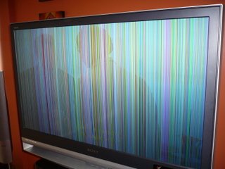

New member Post Number: 1 Registered: Jul-08 | Eric, I have the same Sony television you had replaced. My optical block was replaced a little over a year ago and I think I'm seeing the early signs of another failure of the optical block. My first block had the blue haze at the bottom of the screen. Now, in both upper corners of the TV screen, I'm seeing faint scribble marks. They are more easily seen on white or blue backgrounds. The scribble on the upper right looks as a kid took a marker and scribbled up and down about two inches proceeding across the screen about 18 inches. The scribble in the upper right is the same except the scribble goes down the right side. My question, did any of your four optical block failures proceed in this fashion? Right now, the scribbles are same as the background color, but always a few shades darker. I bought the TV in December 2004 and my extended warranty will expire in December. If the block is starting to fail again, I'm going to attempt to have this TV replaced as I don't think Sony will ever have a long term solution for these optical blocks. Thanks |
Bronze Member Post Number: 99 Registered: Jun-07 | Jeff, If the problem shows up well enough that you can take pictures of it please do so and post them here. It sounds to me like you have the second major problem with the rear projection TVs, which is the scribble/etch-a-sketch issue. Haven't seen anyone with this problem for quite a while so it's possible they've corrected whatever was causing this problem, though your TV might not have the updated part. I think this was also an Optical block issue but I'm not positive, it might be an issue with one of the boards. Either way, if it's what I think it is, then it's a well known and well documented problem on this message board. Search the archives either for keywords such as "scribble" or "etch", etc., or just scroll through them and look for pictures illustrating the problem then read the associated posts. Bottom line is that you're covered either through the current extended warranty on the OBs, or through your own extended warranty. Still, I definitely suggest you do what you mentioned and that's to try and get Sony to credit you toward a new Sony LCD. The TV is pretty old so at best you might get about $1,000 credit toward the LCD, but that's not bad after about 4 years. If Sony refuses then let them fix it and then just sell it outright. DON'T get it fixed under warranty before you try to have sony exchange the TV, they won't do it after it's been repaired. Let me know if you still need assistance and don't forget the pics if you can. Keep us posted. Eric |
New member Post Number: 2 Registered: Jul-08 | Eric, thanks for the information. Right now the scribbles are faint enough I don't think I can get them to show up on a picture, but they do look like the pictures I've seen here, but more faint. If they become darker, I will get pictures posted. I plan on having this set replaced as I don't think it's worth having fixed since I think it will continue to have problems. Thanks again for the information. |
Bronze Member Post Number: 100 Registered: Jun-07 | Jeff, At least you've identified the problem. Good luck with Sony, I don't think you'll have much trouble getting them to credit you toward a different TV but if you do let me know. |

New member Post Number: 3 Registered: Jul-08 | Steve, I checked your website. My scribble pattern is not as discolored as the examples on your site. What I'm seeing my screen is fairly faint scribble which is the same color as the surrounding background. I just noticed these patterns within the last three or four days. I do have an extended warranty through Circuit City with this being the fourth repair to the set. My warranty states if the set requires a third repair I should fall under the 'no lemon' guarantee. I don't know what luck I will have with Circuit City, but will be trying. Thanks for the help. |
Bronze Member Post Number: 66 Registered: May-07 | The scribble is pretty distinctive, so you don't have that. In any event, if you are doing this through a Circuit City extended warranty, it doesn't matter. The extended coverage I was talking about was a warranty extension through Sony. Good luck. | |

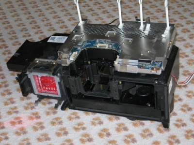

New member Post Number: 2 Registered: Sep-07 | well here is my problem,kdf55xs955 trapezoid problem. after replacing the optical block ( $668.00 taxes in)I find the picture shrinks on the sides by 5/8 of an inch from bottom to top. Is there an adjustment for this in a sub menu or did I install the block incorrectly?p.s. for all Canadians order from Sony in St Louis and ship to a U.S. address far cheaper than in Canada thank you for any help. Regards Scott | |
Bronze Member Post Number: 69 Registered: May-07 | Bob Scott, the problem you describe can be the result of the optical block not being physically aligned properly. Make sure that it is fully screwed in such that it is tight against the "gasket" around the hole on the chassis that leads to the screen. In addition, there is probably an adjustable wedge-shaped device on the back of the TV that may allow fine adjustments. | |
New member Post Number: 3 Registered: Sep-07 | thank you I will remove and realign the block will give you the result.....and to all it is not a huge job to re and re a block,with a digital camera you can make your own tutorial. thanks again Steve Linke BYE | |
New member Ottawa, Ontario Canada Post Number: 2 Registered: Jul-08 | Thanks for the warm welcome to the club, Eric -- misery loves company. Unfortunately, I purchased the TV in Dec. 05, so it is well out of warranty. I will set up an appointment with a Sony technician to get the official diagnosis and then talk to Sony Canada about what they can do. I'll follow up with the ERC based on the results with Sony Canada. Dave. |
New member Post Number: 4 Registered: Sep-07 | thank-you Steve Linke I adjusted the position of the block and all is well now. to David Simser here is the phone number of Sony parts in St Louis if you are forced to fix it yourself 1-800-488-SONY (7669 |

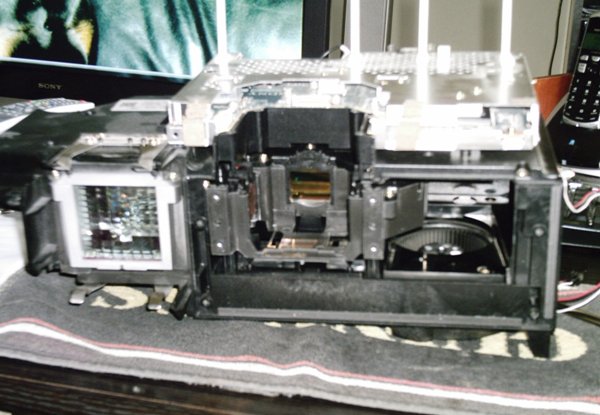

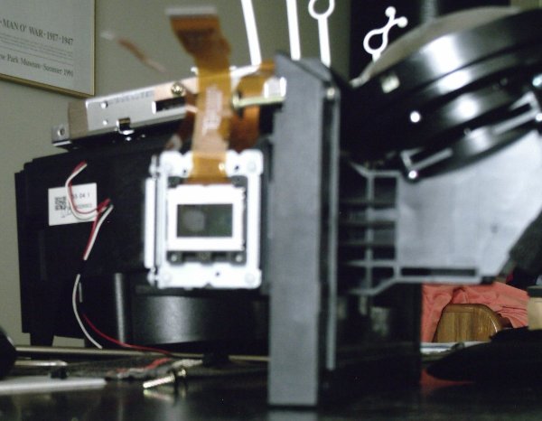

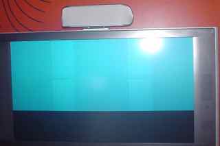

New member Post Number: 5 Registered: Sep-07 | well I replaced the block on my kdf55xs955 as stated in an earlier post, took the old block apart and here are a couple of pictures of the blue blob problem. As you can see in picture 25a the light source (shiny glass square on left)is only 1" from the blue output so the overheating problem would affect blue first. green is in the center and red on the right side. Picture 34b shows the damaged area it looks like a haze. ![]() |
New member Post Number: 6 Registered: Sep-07 | I would be happy to help[ anyone in the toronto area that is doing a re and re | |
Silver Member Post Number: 110 Registered: Jun-07 | Bob, Unfortunately I can't really make out much from those pictures, it would be great it you could take some very good pictures that clearly make out the location of the blue LCD relative to the light source, and more importantly ones that clearly make out the haze/damage to the blue LCD. Although there are very good pictures of a disassembled OB from one or two others owners, none of them show damage to the LCDs from what I recall. There has long been speculation about this problem and what was causing it. Those of us that are most familiar with it I believe share the general consensus that it was most likely caused by some sort of overheating (or extended exposure to heat) from the light source. Since different models suffer from different colored "blobs", it was assumed that the LCD panels were in different locations relative to where the light source is on the OBs used by various models. Again though, to the best of my knowledge this has always been speculation and there has never been any visual evidence either that the affected color LCD is always next to the light source, nor any evidence in the form of a damaged LCD such as what you're describing. Any pictures and information you can provide about the damage to the blue LCD panel would be helpful. I'm particularly interested to know if the damage is on the the surface of the panel or within the panel itself. |
New member Post Number: 7 Registered: Sep-07 | send me an e-mail with your address and I will mail the defective part to you for analysis | |
Bronze Member Post Number: 70 Registered: May-07 | Although the pictures are a bit out-of-focus, they certainly add some additional clarity to the nature of the problem. When I took my TV apart and got to the optical block, I took the LCD panel cover off the top to reveal the three LCD panels themselves. At that point, I noticed that the one labeled blue was closest to the lamp, which prompted me to speculate that it probably got the hottest of the three and was the most likely to degrade over time (see Pictures 3 and 4 and the commentary on my web site). However, I decided not to go any further to open up the optical block, so I could only see the panels looking down through the top of the block. Bob seems to have removed the projection lens portion from the side of his optical block, allowing a new view directly at the LCD panels (compare his pictures to my Picture 3). This further emphasizes the proximity of the blue LCD panel to the lamp, and I can clearly see an oval-shaped gray haze on the left side of his blue LCD panel. Bob, do you have any pictures with better focus. In either case, would you mind if I added some of your pictures to my web site? I set up an email address for this topic which is near the top of the page linked above. Otherwise, I could just download the ones you posted in this forum. Thanks. |
Bronze Member Post Number: 71 Registered: May-07 | Bob's first picture also clearly shows a second centrifugal fan on the bottom of the optical block (right side). This fan likely works in conjunction with the similar centrifugal fan (on the top of the other side of the optical block) to try to cool the LCD panel area. It is pretty clear that the cooling is insufficient, particularly by the blue LCD. I also wanted to point out another web site I link from mine by somebody named Paul Patience. He also dismantled his optical block--in his case, to clean dust out of it. This is a different problem that usually manifests itself more as small (quarter-sized) finger-print looking anomalies on the screen of various colors (highly magnified dust particles). In any event, |

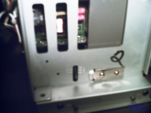

New member Post Number: 9 Registered: Sep-07 | here are a couple of sharp pictures of the block and Steve you can download the full res pictures at thanks to Michal at preludephoto.com ![]() |
Bronze Member Post Number: 72 Registered: May-07 | Thanks, Bob. | |

New member Post Number: 10 Registered: Sep-07 | Hi! For anyone who is replacing the block themselves and has an issue with the alignment here is the answer. The pictures aren't very clear but the screw to the left of number 2 will raise or lower the blocks picture by moving a shim.hope this might help someone.CHEERS! ![]() |

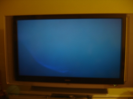

New member Post Number: 3 Registered: Jul-07 | Hello All, last night I have discovered what I think it is Blue Dot as Sony calls this issue. I have KDF-55XS955 and so far I had issue with thermal fuse and replaced lamp. I have purchased TV 12/2004 and TV was manufactured on 11/2004. I understand that this is still under extended warranty (if this is optical block issue). Please check images and let me know if this is in fact optical block or Blue Blob issue. What should I do contact support and go from there? Can I send digital images to Sony support or they will require to send technician? Please anu suggestions are welcomed. I have read most of the posts on this forum but still would like "confirmation" from people that have expirienced issue. THANK YOU SO MUCH. ![]() |
Bronze Member Post Number: 73 Registered: May-07 | Mirzo, this looks like the blue haze/blob issue to me. Call Sony. | |
New member Post Number: 4 Registered: Jul-07 | Thank you Steve. Should I just go to regular procedure and call their support? Do you now if they have to send techinican or they will accept digital pictures. I have registered with them when I purchased TV. Again thank you for response. | |
Bronze Member Post Number: 74 Registered: May-07 | You would think that Sony would accept digital pictures, and then directly send a technician with an optical bock with them on their first visit. However, it seems that they always require a preliminary technician visit, which turns into ~$100 for 5 minutes. The good news is that Sony covers this cost, if it is determined that it is an extended coverage issue. | |

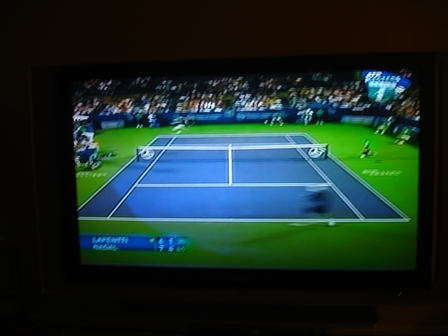

New member Post Number: 1 Registered: Aug-08 | Hi all, I think I have a different problem. Over all screen is good no lines or blotches. However, After Tvhas been on for about 1 hour the quality of the Yellow in the picture gets muted. Have TV KDF-E42A10 hook up to Comcast HD box. This just started happening within the last week. WEnt to Sony's website saw issues with software put in my model number and serial number and was told mine didn't have problem. Have yet to e-mail Sony put guess I have too. Anyone else have this type of problem. |
Silver Member Post Number: 112 Registered: Jun-07 | Kevin, Haven't seen any other reports of that problem here on this board on the last year or two that I can recall, with your model or any other RP Sony TV. The A10 series is still moderately new though so problems with that series have only recently started to show up on the radar (mostly just the typical blob issues). You're going to need to have a Sony tech diagnose it and take it from there, can't really speculate what the problem may be. Hopefully you have an extended warranty, if not, you may still be covered if you purchased the TV on a credit card within the last 2 years. |
