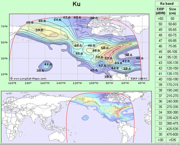

Hello everyone
I got a great question for Satellite hobbyists
Can yo put a linear LNB on a 24" dish?
Can yo get FTA on a 24" dish?
The answer is yes mainly on Galaxy 18 at 123.0°W
But it depends on where yo live
East cost is the only answer
I never tried it
But I advised few hobbyests on the east cost they came back thrilled to tell me it does work great
But yo have to look at the map below:
http://www.lyngsat-maps.com/maps/galaxy18_ku.html
Here is how to:
- first look at map to determine yor location
- Basic linear LNB
- Dish 500 or old DTV dish 20" to 24"
- Yo'll need to determine 3 items:
* Azmith
* Elevation
* Tilt skew for LNB
Use: http://satcalculator.freehostia.com
Put yor zip code and selecting Galaxy-18 123W
Please note linear LNB requires rotation inside its universal bracket or entire dish to be moved if yo are using rectangular linear LNB
Make sure yo use a KuLo LNB (KuLo=11.7G)
This is a great LNB can work as Linear or Circular even on 118.7
Zinewell ZKF-G52N or digiwave
12.2-12.7GHz
It's a dual LNB for about $20
Can work on an old DTV or dish 500
I base my calculation on a 49dbW
Dish size 55" to 65" from above table
Average is 60"
60/2.5=24
BELIEVE ME GUYS IT WORKS
Yo can also get C-band on a 1.2Meter dish

It is a good presentation
He's right about one thing
Newer satellites got stronger signal
But this individual is unaware that signal can be calculated and size of dish can be determined by signal level value straight from foot prints
Also he's totally unaware that it depends on which satellite and where he lives
My first post is to show everyone that a 24" dish can be used on a linear LNB
And there is no need for trial and error
Size of dish can be easily calculated from foot prints
Trust me
It works just like I explained above

I repaired my problem with my motor, a simply bad contact on a connector.
I see this satellite this morning on Lyngsat, but not scan it.
I scan Galaxy 18 tonight and i get 20 channels, but i have a big tree btw the dish and 123W position.
This satellite provide a strong signal if i consider my location and the neighbor tree directly in signal.
I am sure than everybody from USA and Canada can get this satellite from a dish size btw 18" and 36".
The interesting thing is: this is probably the best satellite Ku Free to Air Local Channels for now.
Thanks for the info King

All test are performed from Toronto.
Note i get many channels not available if i look on chart from Lyngsat from my position with a small 90cm dish.
