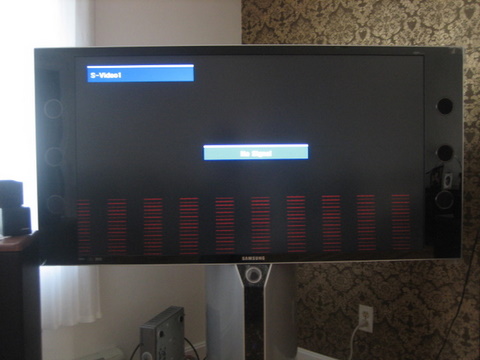

New member Username: XrufisxPost Number: 1 Registered: Jan-08 | I have a HLP4667 about 3 years old. A while back I noticed that if shut off then turned back on I would loose color. Now, there was still "color" it just seemed as if there was no red present this would stay indefinatly until you read further. Now if i turned the tv off and kept it off for at least 20 minutes then turned it back on the color would still be missing. However, if I waited 5 seconds the color would start flashing in as a seperate image. It appears to move horizontally across the screen at I would say tens of revolutions a second staying in some spots longer than others but always longer in the same spots. Allowing this to continue for about 20 seconds it would "snap" inline with the out of color image and the tv would function perfectly. Until powered down. This technique ONLY worked while the tv was set to dynamic. Now, the color flashes but never "snaps" into place. Had a tech out, he replaced the board the hdmi and dvi connect to but that didnt work. He didnt call me or answer the phone for 3 weeks so screw him. Any suggestions? I have tried a variety of things. The only thing I find worth mentioning is, if I disconnect the color wheel by only the white wire, keeping the flat wire connected, the color wheel upon power up of the unit does make noise everytime it spins up however it is much louder than the normal spin up noise. However with both wires connected just the normal spin up noise occurs. Suggestions and thoughts appriciated. | |
New member Username: XrufisxPost Number: 2 Registered: Jan-08 | Also, if it is not (mute 182) to enter the diagnostics, if anyone knows how that would be awesome. | |

New member Username: XrufisxPost Number: 3 Registered: Jan-08 | Update: Tv started doing this, can you see the double image appearing. . ![]() |
