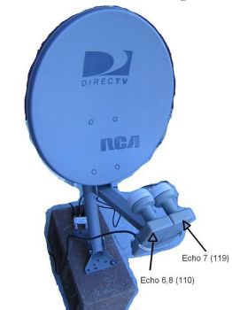

I have 2 dish 1 with 61.5 and other with 119. The other day i bought a new LNB for 110 n i Installed it next to my 119 but for some strange reason im not getting any signal for 110, I was told if i install a 110 lnb next to my 119 i will catch a signal for 110..Do you guys know what im doing wrong?? Plz help

Vic check the skew with your location with dishpointer.com

Looking at the front of your Dish.
Did you install you new LNB for 110
to your right or to your left of 119?

white hawk i installed it to the left of 119

Plymouth wat is the LNB skew can u show me a pic so i get an idea.

The 119 should be a little higher than the 110, about 1 inch, depending on your location..but this is NOT skew....You need to get the correct azimuth and elevation by using www.dishpointer.com web site for your location..skew is rotating the dish like a clock or a steering wheel..
