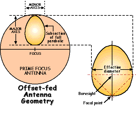

I don't understand your above diagram could you please explain ?
Username: Plymouth
Quebec city, Quebec Canada
Post Number: 4014
In clear term if you fit a second LNB, this LNB cant be in the best Axis and you surely lost signal strenght.
