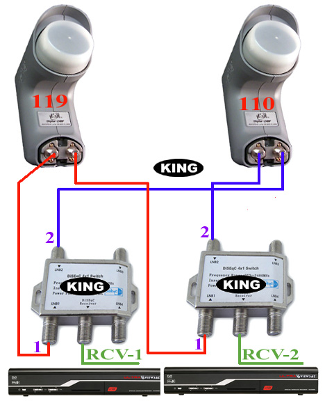

Any help with this configuration would be greatly appreciated.

This can be used as 5 Lnbs to 2 receivers
But may have to combine 2 LNBs must as Twin to use all 5
https://www.ecoustics.com/cgi-bin/bbs/show.pl?tpc=2&post=1612888#POST1612888
4 Satellites to 2 receivers
- Yo have to have each Sat on a separate LNB
- Each LNB must be dual input
- Yo may place 118/119 on one-LNB One-input
- Third Sat to input-3
- Forth Sat to input-4 etc.
- Up to 4 inputs to 2 receivers
- If yo need 5 LNBs yo may have to use Twin Type LNB for 110/119 or 82/91
- If twin is not an option then combine 2 LNBs with sw22k or sw4x4 but in many cases one LNB can do 2 satellite or a twin type
