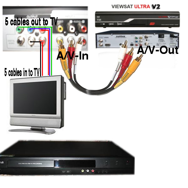

i've been trying to record Shine A Light off of my viewsat but it will only record in B&W...i'm got it wired from the av output on the tele to the av1 input on the recorder...anyone have any ideas?

Try with S-Video
But it is possible your DVD Recorder have a lock protection
I use a cheap DVD Recorder from Walmart and work fine

Make sur yor not recording in PAL
What's yor recorder's model?

thanx for your response....lock protection?i can record from another dvd player or from a vhs player onto the dvd recorder with no problem ...does your signal come in from the dish to your dvd recorder and the to the fta,or is yours hooked up like mine just using an out on the tv?

I Use S-Video and Left Right Audio RCA
Quality is great

its an lg-lra850....i don't think there is an s video out on my tv....i can copy vhs or dvd to dvd using the av out from the tv....just not able to copy tv....

You read it on normal video out
You connect the receiver directly on DVD Recorder and take output of DVD Recorder and hook it in your TV

i tried it it doesn't work....i asked this question in the home vid section as well and put in a few more details about the system if your interested....you can take a look at those posts

Better Off Red
Yor connection is wrong
David Massey tried to tell yo that
Yo can't connect reciver to TV and from TV to recorder
Yo have to connect Receiver to Recorder and out of recorder to TV
A matching Input from remote must be selected so yo can watch from recorder to TV
Follow my diagram:
This recorder is a progressive scan output
i.e.
5 Cables (component out) must be connected to TV
Username: Shadycove
Post Number: 199
thank you...works
