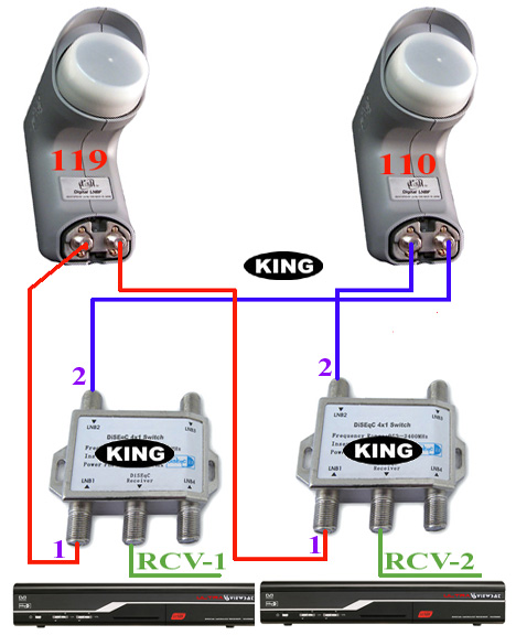

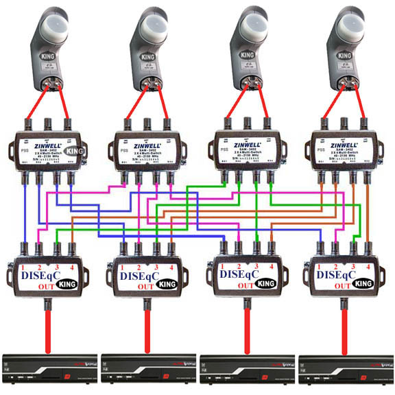

Gold Member Username: TapemanNew York City in-HD, NY Post Number: 3414 Registered: Oct-06 | 4 Satellites to 4 Receivers ![]() |
Gold Member Username: TapemanNew York City in-HD, NY Post Number: 3415 Registered: Oct-06 | 4 Satellites to 2 receivers - Yo have to have each Sat on a separate LNB - Each LNB must be dual input - Yo may place 118/119 on one-LNB One-input - Third Sat to input-3 - Forth Sat to input-4 etc. - Max 4 inputs to 2 receivers ![]() |
