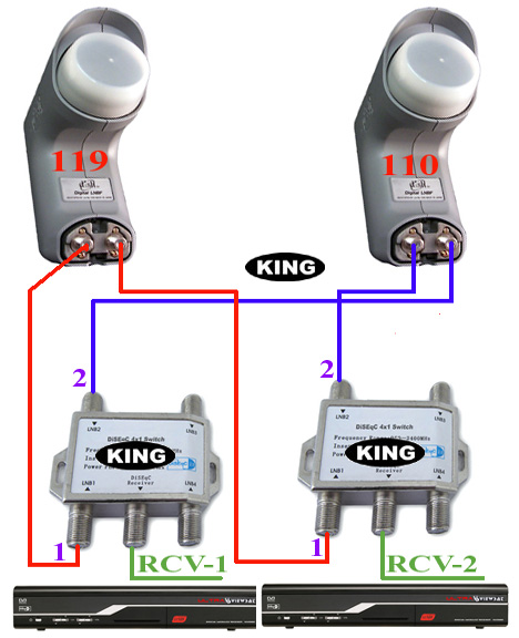

If all yo want 2 receivers and up to 4 satellites
This might be yor best choice:
Keep in mind each LNB must be dual output
Sat-1 to port-1 on both DISEqC switch
Sat-2 to port-2 on both DISEqC switch
Sat-3 to port-3 on both DISEqC switch
Sat-4 to port-4 on both DISEqC switch
2 receivers, 4 satellite simple wiring

using dp34 u only get a max of 3 satelitte and using up to 4 receivers. and 1 condition all lnb's are dp. your only solution is 2 x 4x1diseqc and all your lnb's are dual .
Username: Cartier1
Post Number: 1985
that's exactly what king is trying to tell you.

But yo want run to any problems if all LNBs are dual, wire to DISEqC switch like above diagram and yo'll be all set

I don't advice yo to buy DP44
It requires stackable LNBs DPP
make sure yor LNBs are dual
And simply use 2 DISEqC switches

Dual means has 2 output just like LNB above marked 119
or lik this
http://www.solidsignal.tv/prod_display.asp?PROD=101001
Twin LNB is like 110/119 but must have 2 outputs as well
