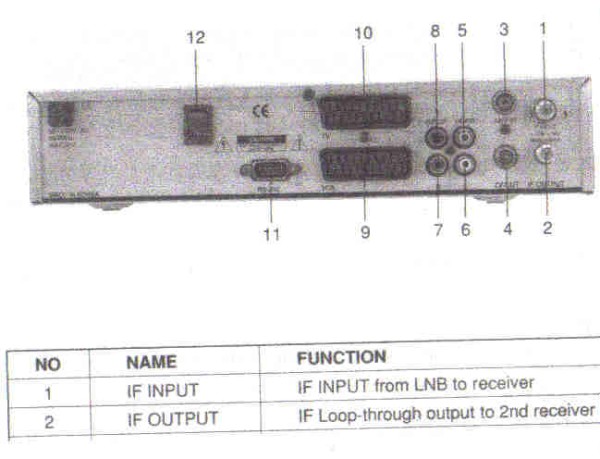

Silver Member Username: MuchoPost Number: 584 Registered: Dec-07 | Thread: DiSeqc signal plitted J-RON New member Username: Rivman SOL Y PLAYA, PR PR Post Number: 7 Registered: Jul-08 Posted on Monday, September 01, 2008 - 09:02 pm: -------------------------------------------------------------------------------- Is it possible to split the signal from the cable that runs from the DiSeqc (receiver port) to the back of the receiver, to connect another receiver. In simple terms; connect two 2 receivers to one input line from DiSeqc. Has anybody done it? } In simple terms;(YES) A) As Kingfish had posted above, I mean King Tapeman. B) Also you can can connect from the port back of you receiver marked IF Output to your second receiver. Not a very good installation but I have tried it both ways and it does work. BTW King I just knew if I stay here long enough we would agree on something. ![]() |

Gold Member Username: TapemanNew York City in-HD, NY Post Number: 3340 Registered: Oct-06 | I do agree IF out won't control second receiver I think what he meant is (Loop out) Loop out is like a splitter Splitter can work like I said above 1- to each receiver But must turn off one reciver while watching the other J-RON might be happy with that |

Silver Member Username: MuchoPost Number: 590 Registered: Dec-07 | King, what may I ask is the difference between connect or Loop through? B) Also you can can connect from the port back of you receiver marked IF Output to your second receiver. Not a very good installation but I have tried it both ways and it does work. I only answer the man's question, he didn't ask for a better way. Yoy can't answer peoples questions by just reading and not testing. ![]() |
Gold Member Username: TapemanNew York City in-HD, NY Post Number: 3350 Registered: Oct-06 | "King, what may I ask is the difference" WTF Speak englic MOFO - IF input is from LNB - IF out is to TV - IF out can goto anothoer receiver as Antenna Input - Loop out is to a second receiver if necessary "B) Also you can can connect from the port back of you receiver marked IF Output" What the fluck is this? How hard is that Ass_gap? Work on yor IQ kid This is embarrassing I thought yo were making progress last month Yo can connect IF out to another receiver as an antenna input That is considered modulated frequency in 900MHz His question was how to split DISEqC signal I hope this helps yo kid That's what LK was trying to tell yo as a slave unit Read it 10 times so yo can get it |
