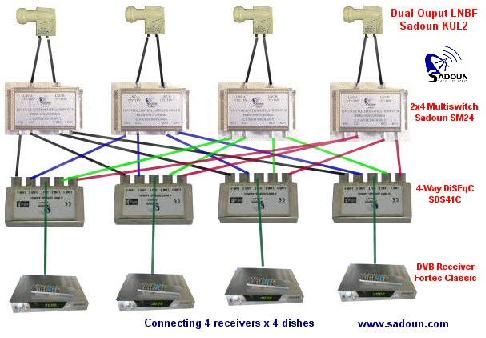

Here is the good way to connect your 3 receiver(3 tuner on 2 receiver)
Keep this diagram, if you want add LNBs and 1 more receiver
Use 1 multiswitch and 3 diseq

cut that in half for just the 2 recievers, or get a quad dp lnb, would be sooo muc=h easier.1 wire to the sv 4000, 2 to the sv elite. the elite is awesome.

thanks guys. this quad lnb u speak off... is it mountable on an 23" eliptical dish.

Yes the Dish Pro (DP) Quad LNB (made specifically for 2 sats 110-119 or 82-91 to 4 receivers with a built in external switch) mounts fine on the 23" elliptical dish.
