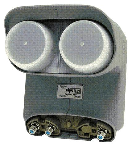

I have another question for King, How can I tell the difference between a dp, dp+ and twin lnbs when it has no stickers or any kind of labels?.
Username: Tapeman
New York City in-HD, NY
Post Number: 3147
DPP or DP+ is stackable polarity
It converts 13/18V dual polarity to one odd and even polarity but stacked to one 20V common polarity
Is like a dual LNB outlet but instead of runing 2-coax cables 1-coax can power a dual tuner receiver

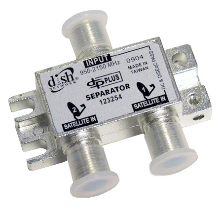

It can be seperated using this Separator
The same 1-coax can also combine 110/119
And maybe splitted without sharing polarity
It uses 20V after stacking
DPP can also stack a third Sat 61.5 (option)
DP44 SW can perform same task of DPP
