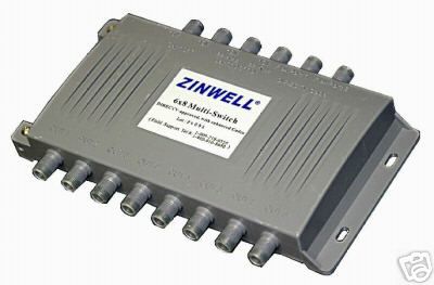

6x8 switch is the only option for 3 sats to up to 8 receivers

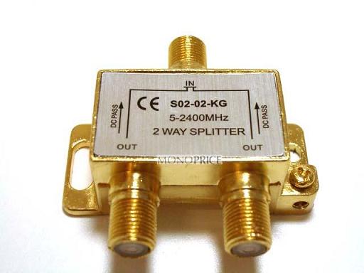

If yo use a splitter it must be high freq
2GHz or 2000MHz
2.4 G or 2400MHz
Any splitter less than 1800M will not work
900M or 1000M will not work

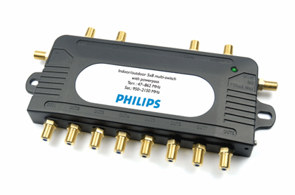

So i bought a Philips Multi-switch SDW5058. Which port gets which wire? i have 3 wires for 3 lnbs. 119 is one wire. 110 is one wire. 61.5 is one wire. The five inputs are labeled. port 1 terr. port 2 18v. port 3 13v. port 4 13v/22khz. port 5 13v/22khz. where does each lnb wire go?

Actually I just checked the specs on this switch
This is called 5x8 Switch
2 Sats and 1-Terresterial antenna
2 sats= 4-inputs + 1-antenna
I'm afraid this won't work on 3 sats
2 sats or yo share polarity on the others
