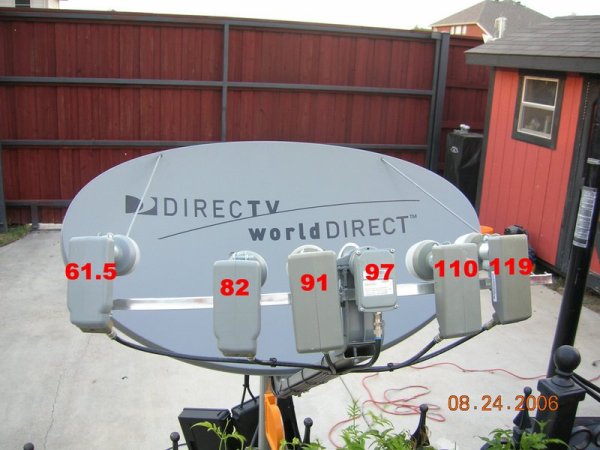

Gold Member Username: Cartier1Post Number: 1920 Registered: Feb-07 | I DO HAVE ALL OF THESES IN SAME DISH . use global cast dish 33' oval. but you habe to make your own bracket, first you have to point to 97w and then a metal bar that you adjust each sat . i will work . |
Gold Member Username: CavelarWOODBRIDGE, ONTARIO CANADA Post Number: 1213 Registered: Jul-06 | ![]() |
Gold Member Username: Cartier1Post Number: 1922 Registered: Feb-07 | THE 61.5 DONT MAKE SENSE TO ME . AND WHY DONT YOU TAKE A PICTURE OF THE FRONT I WANNA KNOW HOW THE LNB;S ARE ATTACHED TO THE BAR |

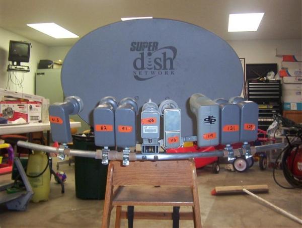

Silver Member Username: VittuPost Number: 250 Registered: Oct-07 | another pic from another with little more ![]() |
Platinum Member Username: NydasPost Number: 11070 Registered: Jun-06 | Vittu: You have stretched my credulity to beyond the breaking point. 40 degree span on one dish is achievable - beyond that is sheer fantasy. |
