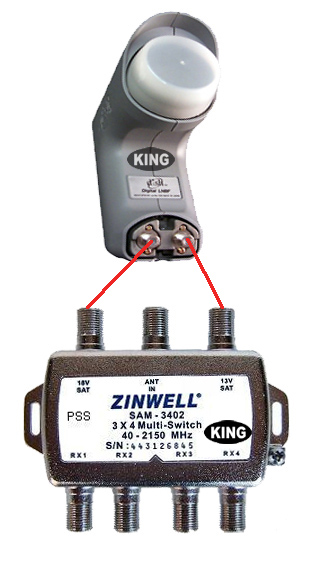

New member Username: BdrPost Number: 4 Registered: May-06 | I currently have a dish 500 with a DPP twin LNB that is serving 2 dual tuner 322 recievers (4 rooms total). What is the most cost effective way to get a signal for a 3rd box into a 5th room? Is there a way I can just "split" one of the feeds to one of the 322s? |
Gold Member Username: TapemanNew York City in-HD, NY Post Number: 2962 Registered: Oct-06 | In yor case (Sw 3x4 $10 from e-bay) Yo take the 2 input Connect to 3x4 Sw Yo get out up to 4 outputs - One of the input to first dual receiver - Second input to second dual receiver - Third to yor 5th room - Fourth output to any future expansion Reference from King's archives: https://www.ecoustics.com/electronics/forum/home-video/462579.html ![]() |

New member Username: BdrPost Number: 5 Registered: May-06 | Hey sorry was really busy today just got home lol. But will that interfere with the Dish plus Pro gear that follows it and if so should I use the DPP-44?? |
Gold Member Username: TapemanNew York City in-HD, NY Post Number: 2981 Registered: Oct-06 | Yor taking 2 inputs and making it 4 outputs Insertion loss is normal Quality may drop 1% to 3% So unless yo got poor signal it should work like a charm |
