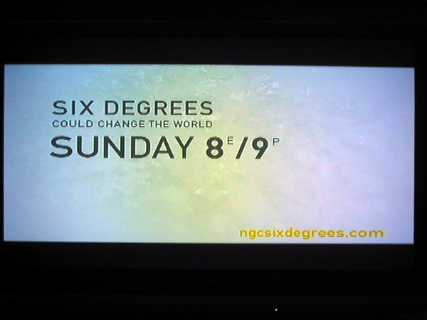

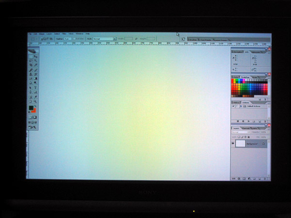

Mine is the lemon picture or yellow stain
My Advice is being patient it took me three and a half months for a resolution.
Write your letters follow procedure, be polite. Sony will work with you.
I received a call yesterday from Randall executive customer affairs; I have been offered a year warranty, a new optical block that Sony will reimburse me for. I pay for labor. Sony pays for the part. This I can do.
Randall has been the nicest person I have spoke with from Sony; he also seems to be the only person that understands three thousand dollars is a lot of money.

I have a KDFE42A10 manufactured 08/2005 and purchased 09/2005. Approximately six months ago I noticed what appeared to be a faint yellowish brown discoloration in the center of the screen. Initially I convinced myself that it was ambient light or my imagination. Over time the discoloration has become much more pronounced.
I contacted Sony yesterday and received the standard brush-off "you are out of warranty, I'll be happy to set up a service call for you."
When asked if there were any service bulletins for this model, I was told that none existed.
The problem is most noticeable with light backgrounds, and the discoloration is the color of "old plastic", yellowed by UV exposure...in these photos it looks more greenish than in person. It is roughly oval shaped with the long axis oriented vertically in the center of the screen.
Any recommendations, thoughts, suggestions would be appreciated.

Anthony Henderson > Please explain "resetting"I have posted pictures of the problem at the following address https://www.ecoustics.com/electronics/forum/home-video/137540.html
Ronnie_ > Okay, Anthony. I saw the pictures.
Ronnie_ > This seems to be the optical block issue with the TV.
Ronnie_ > I suggest that you get the unit evaluated at the Sony Authorized Service Center.
Anthony Henderson > Has Sony extended coverage for this manufacturing defect?
Ronnie_ > Anthony, this TV does not have the recall for the optical block issue.
Ronnie_ > Anthony, I suggest that you have the unit evaluated at the Sony Service Center. Sony technicians will be able to diagnose the issue and help you.

i have KDF-E55A20 with 'fingerprints'in right corner in a size of 20''-30''no extwarr.any with same problem

I posted here with a picture from the TV of what was explained to me as "road map" The TV was a 2004 purchased in 2005 and past the warranty by a few months
They do read this forum and got in touch with me. They were very polite and professional. Sony dominates my house with high end electronics and will continue to do so. Very pleased customer.

I have a KDF-E42A10 made 8/05 I bought at BestBuy 9/05. I have a huge yellow bullseye just appeared. I called Sony service and was referred to QualX for a repair call. QualX called and said there is a $99 destination fee just to show up.
Is this the same problem the folks with the yellow spot in the middle are having? It looks like it could be a test pattern.

On the purple marks my understanding is its usually dust in the optical block, and its not clear if its fixable with a cleaning, some say it is, some say still needs replacement....but definatly worth a shot.
Here is a link from someone who cleaned theirs, and talks about the purple marks. Here is a quote.
http://splinke.googlepages.com/sonykdf-55wf655opticalblockreplacement
"Optical block cleaning (for purple/pink "fingerprints")
The black LCD panel cover can now be removed from the optical block to expose the panels themselves. It is very unclear how best to clean the interior of the optical block. In fact, there have been few reports that the procedure substantially improves the picture. In theory, blowing compressed air over the LCD panels and other internal parts could clear away dust. In addition, the glass on the projection lens could be cleaned with lens paper and solution. Aerosol (canned) air is not recommended, as it can come out very cold and/or spray moisture, so extreme care should be exercised when using it."
