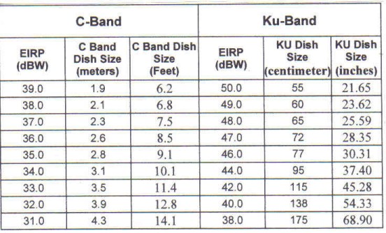

Silver Member Username: King_of_satsPost Number: 284 Registered: Jan-08 | FOOTPRINTS BY DISH SIZE http://www.geo-orbit.org/sizepgs/sizemainp.html |
