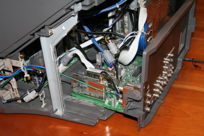

New member Username: Bong2California Post Number: 2 Registered: Jan-07 | Couch potato again!!! As I mentioned before, HLP5063w will cycle on and off, buzzing sound from the back, screen blank (looking at the lamp, it did not look like it's on), and 3 blinking lights of death. I initially replaced the lamp. But it didn't do anything. I then changed the color wheel. The TV fired right up. My guess is that some safety feature prevents the lamp or TV to turn on if the color wheel is damaged. Although, I don't understand why the wheel would keep on turning eventhough it's broken. Replacing the color wheel on the 5063w is alot simplier than I thought. 2 screws from the back holds the metal tray that the lense, engine, color wheel, lamp and fans are connected/screwed on. Slowly pull this metal tray, and unplug whatever connectors(about 4) are keeping it from being pulled out. Finding the color wheel should be easy after pulling this metal tray out. Most of my time were mostly spent vacuuming dust from all the parts. It took me about 1 1/2 hrs, but this is because I wanted to go slow and take my time. Sorry no pics. My camera happens to be broken this week. |
