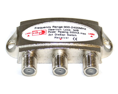

My switch (4 to 1) was working fine for about a week and now it's acting up. I only used 2 inputs with an obvious 1 output. Now I have to disconnect one of the inputs in order to view one satellite and vice versa. I've tried another switch (2 to 1) but same thing with disconnecting in order to view. What could have gone wrong?

Are you using a TV Splitter or a DiSEqC
Switch?

Whitehawk: It's a disq switch NOT a splitter

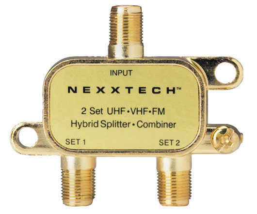

He says on his first line is a switch and was working fine for a week it was plain english language T.F.R. that hybrid sw in photo is a multi purpose splitter/combiner mainly to use to combine/split cable service with satellite signal.
Ken
Anytime yo make changes in coax cables while receiver on can cause voltage/current spikes and possibly can damage skinny coil inside DISEqC switch best advice always turn off receiver before changing cables a simple unplug of cable in back of receiver easily damage one-input or more of that Switch
time to buy another $5 or $6 off e-bay
