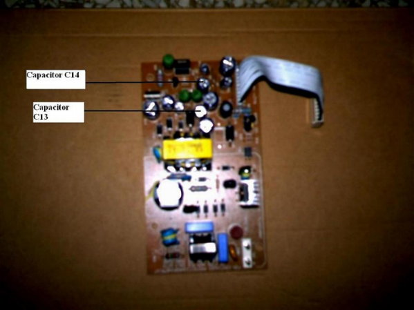

If you tried all of the above and still having the problem, try this. I was having the same problem and this helped. Got it from another site...
Ok for the people with the 99% signal and 0% quality on a Pansat 2700a or the Pansat 3500 , just found out what the problem was, only need to change the 2 Capacitors from the power board , they are mark like c13 and c14 ,
(470uf 16volts) changed them and the quality just went from 0% to 85% , heres a pic of the parts ! My receiver with the same problem and I fixed.
