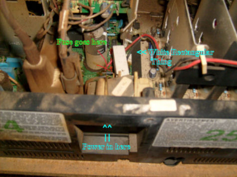

I've got a RCA P60752EB that i picked up at a yard sale for $25. Turned out it just had a bad fuse. then a couple of months later it blew a fuse again. then again. and now, as soon as i put a fuse in, it blows it, starts arcing (where the fuse goes in) and makes a weird noise. The fuse is right on the block that the power cord plugs into, I think this is a power converter or transformer i don't know. I looked at the under side of the circit board for any black spots from any burning, and saw a little browning on one leg of some 3 inch long white rectangular thing. i could really use some help with this. I can not afford to replace the set but if i know what i need to replace i can do it my self. Please any help would be appreciated. thank you.Upload

Also i noticed that the little blue (resistor) next to what i think is the flyback (what ever supplies power to the HV block) seems to be burnt but i'm not sure. it looks like the output side on it is blackend as well as the wire comming out of it. Maybe it's just dirty on that one end or something. Also it runs diagonaly pointing to the fly back and then up and to the left. does this help anyone?
