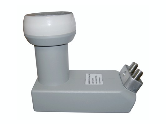

Username: Abj
Post Number: 534
Circular Dual LNB for both 119 & 118.8°W
[118-119lnb]
It's a brand new Ku Band Circular Dual output LNB with Dual polarization. It's designed especially for catching 119 & 118.7 /118.8(Anik F3) at the same time using one such LNB. Each Output gives signal from both satellites.
Features:
* Dual Output; Neck size: 40mm
* Input Frequency Range from 11.70Ghz ~ 12.75Ghz
* Output Frequency Range from 950Mhz ~ 2150Mhz
* ROC Brand; L.O. figure: 10.75Ghz;
* Extremely Low Noise Figure: 0.3dB
* Low Phase Noise for Analog or Digital reception
* Brand new CB2008A type with Excellent stability
* Best solution for individual and multi-satellite systems
* Weather-proof O-Ring and Gasket inside.
ATTENTION
Requires: 30-inch or larger dish
Compatible with DirecTV, Free-to-Air (DiSEqC, 22KHz), and legacy switches (SW21, SW44, etc)
Not compatible with DishPro switches and/or DishPro (stacked) LNB's
Instructions
Using a 30-inch or larger dish (we recommend 33-inch), aim with the following settings:
Satellite Name: 118°W (Anik F3) or 119°W (Echo7)
LNB Type: Standard (or Single)
LO Frequency: 10750 or 10600 MHz
Finally, do an AUTO SCAN or a BLIND SCAN
For some the following settings may work better or give you more channels:
LNB Type: Universal
If your missing any channels, manually scan them. You can refer to www.lyngsat. _ _ _ / www.lyngsat*com/anikf3.html
LO Frequency: 9750 MHz
HI Frequency: 11250 MHz
Make sure Anik-F3 (118.7°) TP figure in your receiver menu is correct.

do i really need a special circular lnb to get 118.7, when 110 and 119 are circular?
correct me if i'm wrong, but on lyngsat under the first column labeled as "Freq. Tp" "R" = right-hand and "L" = left-hand mean they are circular polarizations. and "V" = vertical and "H" = horizontal mean they are linear polarizations. thanks.
Username: Plymouth
Quebec city, Quebec Canada
Post Number: 777
Max
linear is vertical and horizontal
circular is left and right
This LNB is oval on is width and standard is round,
that why it can catch 0.25 degree.
Username: Maxedout
Post Number: 23
thanks Plymouth, that explains why i can't use the exisiting lnb off my 61.5 dish or the 119 lnb to catch 118.7.
Username: Plymouth
Post Number: 778
Max it's 1.25 degree
You may use the same like me, but when we scan, we catch channel on 2 sat with bad signal.
It's better with
Username: Nydas
Post Number: 9112
Max: There are people who have received 118.7 signals with both Linear and circular LNBs. You get a 4 DB drop., and might miss several channels.
The main point is that all of internationals on 121 are moving to 118.7. There is a possibility of 61.5W and 148W internationals being phased out. - No confirmations of this.
You might as well do a good job and use a special Universal LNB designed specifically for the 118/119. The LNB is about $18 to $25. With a bit of effort you will get going nicely.
Alternatively you can get the full 121 to 118.7 conversion kit for about $110 directly from DN. Either way you will be a winner.
Username: Nydas
Post Number: 9122
Note this item:
CIRCULAR DUAL LNB
LNBF CB2008A FTA 118.7
DISH 119 118.8
It's designed especially for catching 119 & 118.7 (Anik F3) at the same time using one such LNB.
