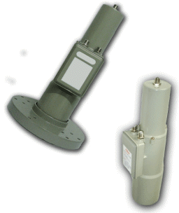

Yo can also get a BSC621-2 C/Ku LNBF that
can receive both C-band/Ku band as well as FSS
C Band
Input 3.4~4.2 GHz
Output 950~1750 MHz
LO 5150 MHz
Gain 65 dB
Ku Band
Input 10.7~12.75 GHz
Output 950~1950 MHz Low band
1100~2150 MHz High band
LO 9.75 GHz Low band
10.6 GHz High band
Direct link
http://wsidigital.com/bsc621.htm
