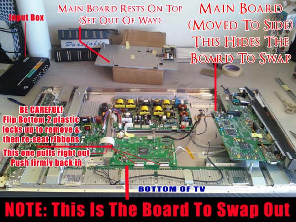

New member Username: Csider702Post Number: 1 Registered: Jun-10 | THANK YOU ALL FOR THE HELP & HERE IS MY CONTRIBUTION BACK FOR FUTURE Do-It-Yourselfers Just letting you guys know that the part that fixes the red vertical line works! Partstore.com was great and it was easy shipping and install as well. I took pictures of the interior once the back metal panel was removed. Here are some tips on doing this from what I wrote down for others that will be wanting to fix the TV themselves. 1.Remove all screws from back of TV panel (yes even the small tiny ones near the bottom) 2.Remove 4 tiny screws around the input box area Lift input box area straight up vertical and it will unseat from the two plugs under it, then remove exposed tiny screws 3. Lift the back metal panel off the TV completely and vacuum dust that has collected on it and lay it some where that wont be disturbed. 4.Take a picture if possible so you reference where screws go and posts go. At this point you'll freak out for a moment because you can't see the board that you need to replace; don't worry, it's hidden under the main board that would be right under the input box that we just removed. 5.Remove back support metal bar by removing two screws left and right. 6.This is where you need to be patient and remove the top main board by disconnecting the plugs and screws that are the grounders. If you have made it this far into your project, you can handle it from here I suppose, as this was my first time without any help or diagrams. Please take a [picture for re setting the parts back in place so you don't forget where they came from.On a scale of 1 to 5 (5 Hardest) I personally would say this is a 2 and only because there are so many screws, ha ha. If you need any more help please feel free to contact me at cside702@aol.com PS. Next reply from me will have the pictures I took with helpful area pointers of the interior of the TV. PART IS:6871QCH038C Cost: $120.95 plus what ever you prefer for shipping http://www.partstore.com/Part/LG+Electronics+Incorporated/LG+Electronics%2fZenit h/6871QCH038C/New.aspx |
New member Username: Csider702Post Number: 2 Registered: Jun-10 | PLEASE READ MY POST ABOVE SO YOU HAVE AN IDEA OF WHAT THIS PICTURE MEANS. ![]() |
