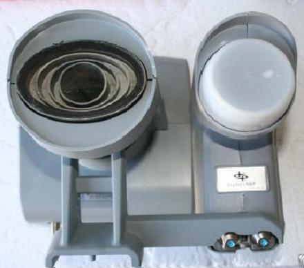

Silver Member Username: One_eye_jackPost Number: 290 Registered: Nov-07 | Repoint Kit Has actually two lnbs inside with two outputs, one for 118.8 and one for 119 ![]() |
Gold Member Username: NydasPost Number: 7724 Registered: Jun-06 | Yokon: Are there two outputs for each of two receivers? The Universal LNBs designed specifically for 118.7/119 give you these two sats for two receivers. |
Silver Member Username: Madflea168Post Number: 160 Registered: Jan-08 | the big one is 118/119, each has its own output, the individual is 110, the one I had just like the one in the pic, has only one output, will need a switch for more receivers. thought I saw somewhere with two outputs on 110 when I google. worked on my dp34 with vs, just need to have adapter to give more power to the switch, vs can't supply enough juice. |

Silver Member Username: One_eye_jackPost Number: 293 Registered: Nov-07 | Nalin,To answer your question YES This Repoint Kit was designed for Dish Network in mind to work with their Receivers and their Dish 500+ I just posted the picture to show what this Repoint Kit looks like. I have never own one , never tested one, never seen one,and don't want one. ![]() |

Silver Member Username: VittuPost Number: 131 Registered: Oct-07 | I have this repoint kit($105 including shippimg from ebay). The fact I don't like it because it's not dual. I can only use it with 1 dish receiver unless I buy a DP44. I have both dish receivers and FTA. I had to setup another dish to get missing birds. |
New member Username: Adam2436Post Number: 9 Registered: Mar-07 | Confirmed: Repoint kit only has one output for each satellite (total of three) - translated to that you have to have DP34 or DP44 to support multiple receivers, plus, they are not cheap and may give FTA box power trouble. Ku Band Circular LNB comes out in single or dual. The Dual LNB, with two outputs for two polarities, can combine with standard multiswitch to handle multiple satellite/receiver situation. |

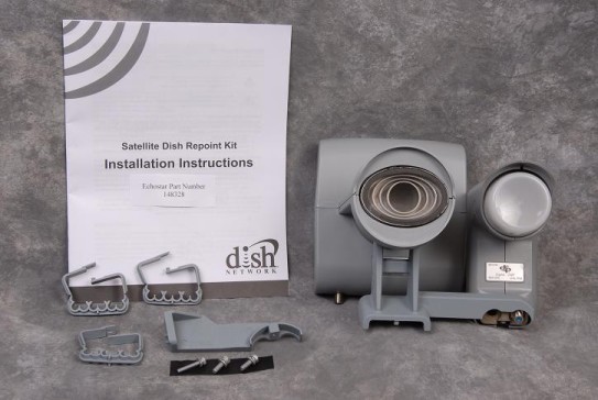

Gold Member Username: TapemanNew York City in-HD, NY Post Number: 2284 Registered: Oct-06 | Another great photo Yukon Great job Let me add few things about repoint kit: - The Repoint Kit allows to convert the SuperDISH to a Dish 500 Plus. - The Repoint Kit is for receiving satellites 110, 118.7 and 119 orbital locations. - The Repoint Kit usually comes with a bracket along with the screws to convert to Dish 1000 Plus. - The Dish 1000 Plus is for receiving satellites 110, 118.7, 119 and 129 orbital locations, however an additional Dish Pro Single or Dish Pro Dual LNBF is required. Reference Last year Timed and dated https://www.ecoustics.com/cgi-bin/bbs/show.pl?tpc=2&post=1006746#POST1006746 |
Gold Member Username: TapemanNew York City in-HD, NY Post Number: 2285 Registered: Oct-06 | This is what the kit looks like C/P from Yukon ![]() |
Gold Member Username: NydasPost Number: 7734 Registered: Jun-06 | For FTA receiver users, it is better to go for the cheaper solution and not buy a repoint kit. |
Gold Member Username: TapemanNew York City in-HD, NY Post Number: 2286 Registered: Oct-06 | Great point Nalin A Universal Circular LNB or Invacom LNB for 118.7/119 is best recommended solution for FTA receivers Repoint Kit is mainly for legit subscribers To convert Dish to 500Plus or 1000Plus Also if anyone got an old Phase II DTV Yo can turn it into a dish 500Plus or 1000Plus by adding a Universal Circular LNB in the middle - To receive 110/118.7/119 For Sure - With skilled pointing and perfect skew yo can get 110/118.7/119/129 - 4-input DISEqC switch (only 2 will be used) - 1-input for 110/129 the other input for 118/119 - This means an additional 97 can be used with an additional 30" dish on one of the other 2 input DISEqC I never tried it But I assure it will work ![]() |
