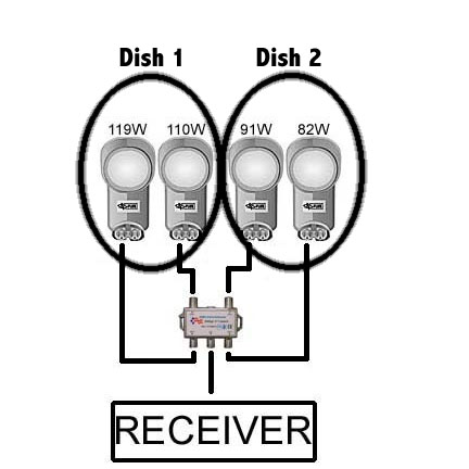

Let me just add 2 dish required for DN and BEV
1-dish for 82/91 and 1-dish for 110/119

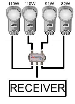

DTV phase3 has 3 LNBs
Middle LNB does not pick up any frequency below 12.5GHZ
Meaning it will pickup very few transponders
however the 2 side LNBs can pick up only 1-DN and/or 1-BEV
So if point middle LNB to 101
Yo'll pick up 91 and 110 only
