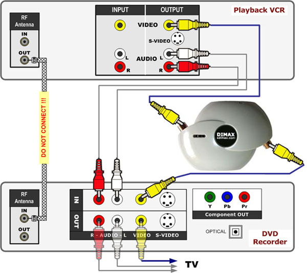

Bronze Member Username: Ieee488Post Number: 25 Registered: Dec-07 | Video is always yellow. Audio is red/black or sometimes red/white. To record from VCR to DVD recorder, you need yellow/red/black OUT from VCR to yellow/red/black IN on DVD recorder. If you don't have this connection, you cannot record from VCR to DVD recorder. |
Bronze Member Username: EllaPost Number: 18 Registered: Apr-06 | This is what you need: And try to go step by step controling video and audio on every step 1. VCR-->TV 2. VCR-->Recorder-->TV Details for grex are here http://www.xdimax.com/grex/grex.html Connection details here: http://www.xdimax.com/grex_faq/faq_howto.html#vcrdvd |
