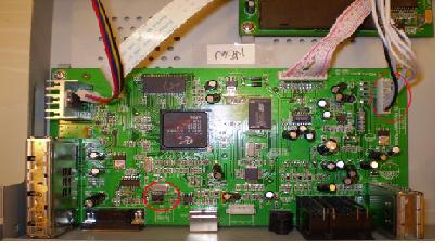

Origonal VS Ultra Upload

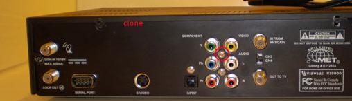

CLONE VS ULTRA CHECK THE RED CIRCLE Upload

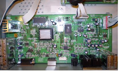

Inside Clone VS ULTRAUpload

Inside Origonal VS ULYTRAUpload

Username: Ragidy57
Post Number: 87
Registered: Aug-07
Thank
with out opening it up. I believe its an original. It has the little heat sink looking silver thing. It also does not have the screws in the back.
