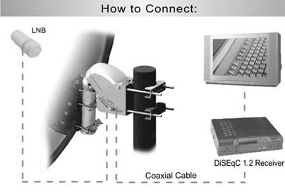

the receiver controls the motor its neat it sends the signal through the coax

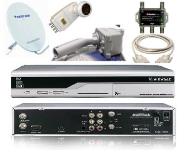

I'm currently using the DN 500 but I have a 31" w/motor and the LNB that's pictured above.I haven't set it up yet does anyone know the settings required(antennas,tp's etc.)?

are all recievers capable of powering the motor?do you have to run additional co ax to motor?
Username: Ke5aqn
Post Number: 2782
every fta receiver I know of can....it sends the signal to the motor through the same coax you already have.It connects from the receiver to motor to switch to the 2 lnb..one cicular one liner

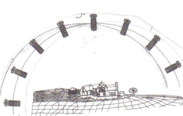

A motorized System is not hard to install.
The hard part comes in the aligment. Yes it's not too hard to hit few Birds in the Belt but to get in the arch where you can scan over (30) Birds
from Hispasat 1C and 1D @ 30.oW to Echo 1/2 @ 148.oW close to (4,000) Radio and TV Channels is not as easy as the tester claims to be.I read here where he was asking how to set it up but could find his true South. Hell his State is facing true South.
AS you can see the solid line is in the Arch
hitting all the Birds. the dotted lines are hitting few Birds. Don't take my work,
check it out.

Username: Ke5aqn
Post Number: 2797
its very easy we get one sat then track in another and do some fine tunning its easy find a week sat to use for tuning 82 is a great sat to use for tuning....as far as trying to find "true south" its too complicated their is a trick to make that easy.....It is easer than tuning in a dish500
