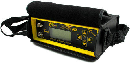

Silver Member Username: One_eye_jackPost Number: 147 Registered: Nov-07 | john You need a Birdog, very easy to use and will find the Birds every time. ![]() |

Silver Member Username: KirankumarNC Post Number: 399 Registered: Oct-07 | the gadget taht Yukon put up is the bet in the market,but who knows how much it costs? |
Bronze Member Username: LoverboyzPost Number: 31 Registered: Aug-06 | I saw the price about birddog on one website its more than $200. Can anybody suggest a cheaper one. |

Gold Member Username: Ke5aqnIF I DONT KNOW THE ANSWER, I WILL FIND... Post Number: 2564 Registered: Sep-06 | bird dog meter on efay now for around $350 |

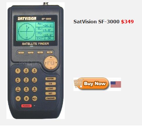

Gold Member Username: Ke5aqnIF I DONT KNOW THE ANSWER, I WILL FIND... Post Number: 2565 Registered: Sep-06 | Good find their lucky I like this one ![]() |

Gold Member Username: Ke5aqnIF I DONT KNOW THE ANSWER, I WILL FIND... Post Number: 2573 Registered: Sep-06 | ya but that meter is "ignorant" it does not ID the sat or have a quality meter for fine tuning...................i like the other one better not that i will ever get one i just use the fta receiver |
