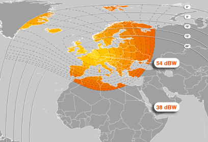

Silver Member Username: MachedonulPost Number: 290 Registered: Jul-06 | EUROBIRD 1 :: 28.5 ° East With twenty-four operational channels, the EUROBIRD 1 satellite provides coverage of Western and Central Europe, extending as far west as the Canary Islands. Designed for the provision of direct-to-home television and multimedia services, the transmit coverage provides high power over several European countries, including Germany and the United Kingdom, permitting the use of very small receive antennae. The receive coverage provides uplink capability over a very wide area. I guess it answers my question ![]() |
New member Username: SignalftaPost Number: 5 Registered: Dec-07 | I looked up my sat location for that bird an this what i get. Latitude: 34.00° N (34° 0' 0") Longitude: -81.03° E (81° 1' 48") City: Columbia/SC Country: United States of America Azimuth angle: 258.78° (True North) Elevation angle: -24.03° LNB tilt (Skew): -54.41° Distance to satellite: 44357.23 Km Signal delay: 295.71 ms (Uplink + Downlink) Declination angle: -22.03° Polarmount hour angle: 284.89° Angle setting on motor: 104.89° West Satellite: Eurobird 1 (28.5° E = 331.5° W) You want to try your location Try this h**p://www.satlex.de |

New member Username: SignalftaPost Number: 7 Registered: Dec-07 | i used this as an example........... Latitude: 35.36° N (35° 21' 35") Longitude: -119.01° E (119° 0' 36") City: Bakersfield/CA Country: United States of America Azimuth angle: 227.74° (True North) Elevation angle: -49.14° LNB tilt (Skew): -37.12° Distance to satellite: 46781.25 Km Signal delay: 311.88 ms (Uplink + Downlink) Declination angle: -52.80° Polarmount hour angle: 306.80° Angle setting on motor: 126.8° West Satellite: Eurobird 1 (28.5° E = 331.5° W) NOTICE the ele angle -49.14 |

Silver Member Username: MachedonulPost Number: 296 Registered: Jul-06 | dude, how do you have your dish with a negative elevation angle? it's in the ground? ![]() |
Gold Member Username: Ke5aqnIF I DONT KNOW THE ANSWER, I WILL FIND... Post Number: 2558 Registered: Sep-06 | That bird is on the other part of the world and out of our reach here in the usa. I clue is its at EUROBIRD 1 :: 28.5 ° East. All the ones we can get are alway WEST NOT EAST. I went and looked at Hope that helps Are the channels on it even in the clear? |
Silver Member Username: MachedonulPost Number: 297 Registered: Jul-06 | thanks dude, i'm slowly starting to give up now i started to realize what these numbers mean; b/c i have a friend that goes up on the house to fix the dish, i never really knew what these numbers stand for...but the negative elevation angle is the reason we can't do it... i figured maybe the new motirzed dishes may pick up signal, what the he-ll do i know? ![]() |

Silver Member Username: MachedonulPost Number: 298 Registered: Jul-06 | but i can't get european satellites from the west coast...what a bummer i would've had 79 romanian channels, one shot talk about yesterday's high and today's low ![]() |
