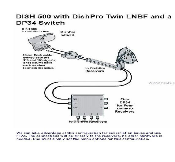

Gold Member Username: Ke5aqnIF I DONT KNOW THE ANSWER, I WILL FIND... Post Number: 2395 Registered: Sep-06 | Stop dish 500 has a switch built in so you cannot use the diseqc that came with the viewsat In order to use both the DN receiver and the fta receiver with the dish500 you have to use a DP34 lets hope that was the switch that was thier from DN i assume. I noticed in your settings for the viewsat you had the Diseqc switch for 119 and also 110 off the set up with the dish 500 is 119 diseqc 1 and 110 diseqc 2 when it is set up correctly with the DP34 try that and lets see what you get |
Gold Member Username: Ke5aqnIF I DONT KNOW THE ANSWER, I WILL FIND... Post Number: 2397 Registered: Sep-06 | ![]() |

Gold Member Username: Ke5aqnIF I DONT KNOW THE ANSWER, I WILL FIND... Post Number: 2398 Registered: Sep-06 | another idea even easer. The dish 500 is a lnb designed for 2 receivers to receive 110-119. It should work great if you set up like this: one port out of the lnb to you DN receiver. One port out of the lnb to your viewsat receiver...set the antenna settings like i said....or you might need to play with switch settings...mine here likes better at 119-setting 3 and 110 setting 4....so play with it What is happing now is the DN receiver is controlling the dish500 for both receivers so its getting all confused.. so please try that no reason why it would not work unless i just thought of this if your DN receiver is a dual tuner and uses both outputs from the dish500 then you will have to have the DP34 |
Gold Member Username: Ke5aqnIF I DONT KNOW THE ANSWER, I WILL FIND... Post Number: 2399 Registered: Sep-06 | ok ok you just answered me the dn receiver is a dual tuner so you need a dp34 or something like it go look at the switch from dn does it have anther out port free? |
