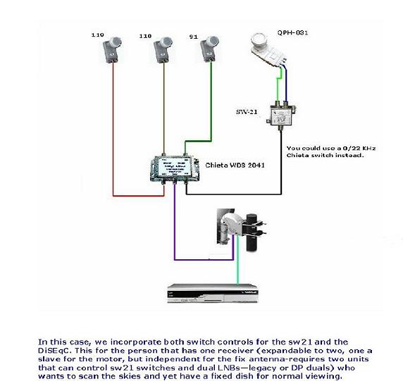

Gold Member Username: Ke5aqnIF I DONT KNOW THE ANSWER, I WILL FIND... Post Number: 2308 Registered: Sep-06 | true on the 1 receiver for each motor....well more than one can use the motorized dish but only one can control the motor. What I am going to set up here is 2 static dish500's one for 119-110, one for 81-91 and the motorized dish all on the same switch. That way all the receivers could watch all of bev, most of dn, and whatever sat the motor is looking at at the same time..I have found that most people who want a second receiver will want it for the kids or wife. The kids or wife are more than happy with DN or BEV all the time so that set up would work out great..... My new set up ![]() |

Bronze Member Username: KrishnPost Number: 36 Registered: Sep-06 | I cant quite understand your diagram Tester, since I am only familiar with dish500, dish500pro and motorized dish features. I am not quite familiar with detailed working of any of them and I would appreciate if you can answer the following questions for me please. QPH-031 in you diagram is physically on the motorized dish right? Does the motorized dish require inputs to Diseqc switch and output from Diseqc switch to pass through motorized dish? (or I am reading your diagram wrongly!) Don't you need only one feed from each of the dish500 (for 100/119 and 82/91) per receiver? |
Gold Member Username: Ke5aqnIF I DONT KNOW THE ANSWER, I WILL FIND... Post Number: 2358 Registered: Sep-06 | AS the diagram shows yes both lnb's in the qph-031 pass through a diseqc switch. This set up uses 3 single lnb's as well no dish-pro or dish 500 used in that sample. If their was dish 500 used yes you would have 1 out to each receiver for 110-119. The dish 500 is complex to get to work in a system such as that with its built in switch so we use single lnb's. With useing a dish 500 its fairly easy to add 1 or 2 more lnb's but not 3 like we see on that system. Hope that clears that up for you |
Bronze Member Username: KrishnPost Number: 39 Registered: Sep-06 | Thanks. if I understand your diagram right i) qph-031 is on motorized dish and other three LNB's are on static dishes. ii) Motorized dish LNB's are connected to Diseqc switch through sw21. iii) Diseqc is connected to the receiver through the motorized dish |
Gold Member Username: Ke5aqnIF I DONT KNOW THE ANSWER, I WILL FIND... Post Number: 2361 Registered: Sep-06 | Yes you got it! I am collecting the parts now to change to that set up. I will have the motorized qph-031 I use now and 4 other LNB's on static Dish antenna's |
